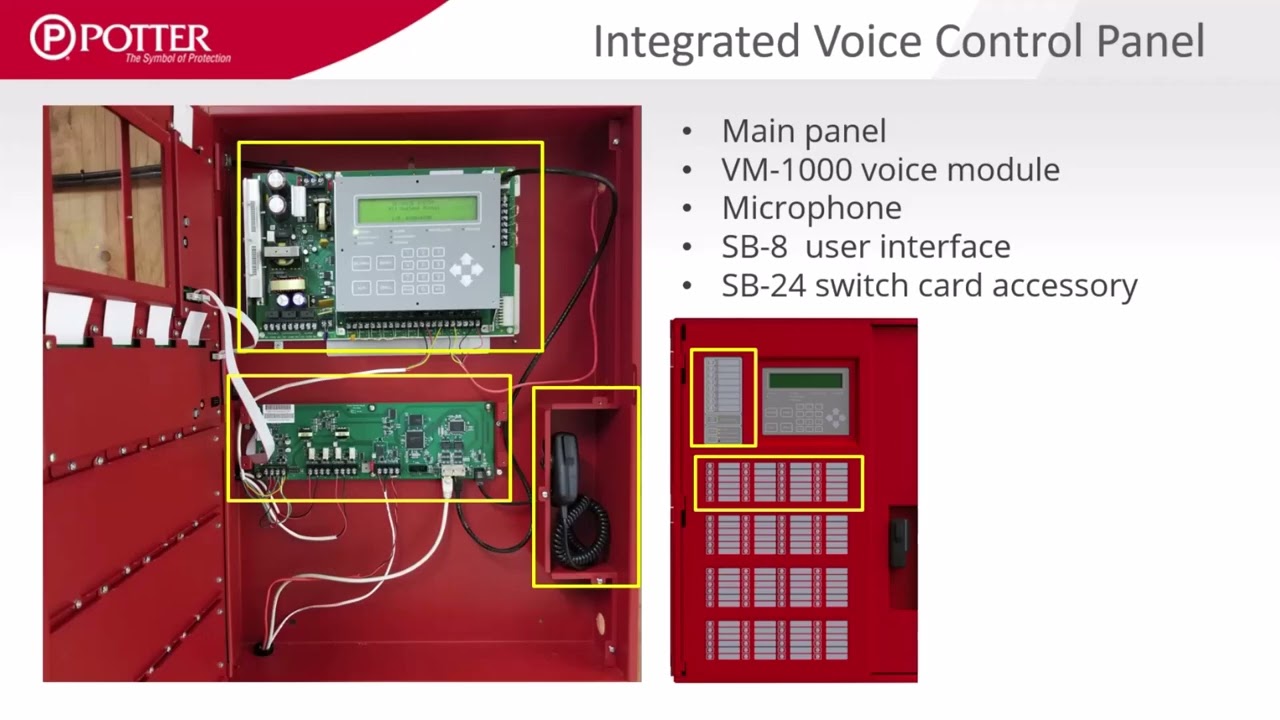

New Potter Voice Panels
I saw this Reddit post:
https://www.reddit.com/r/firealarms/s/BiUTm7E769
It appears that Potter will be releasing some new panels with integrated voice evac for smaller applications. It also appears that they are working on updating the EVAX line.
