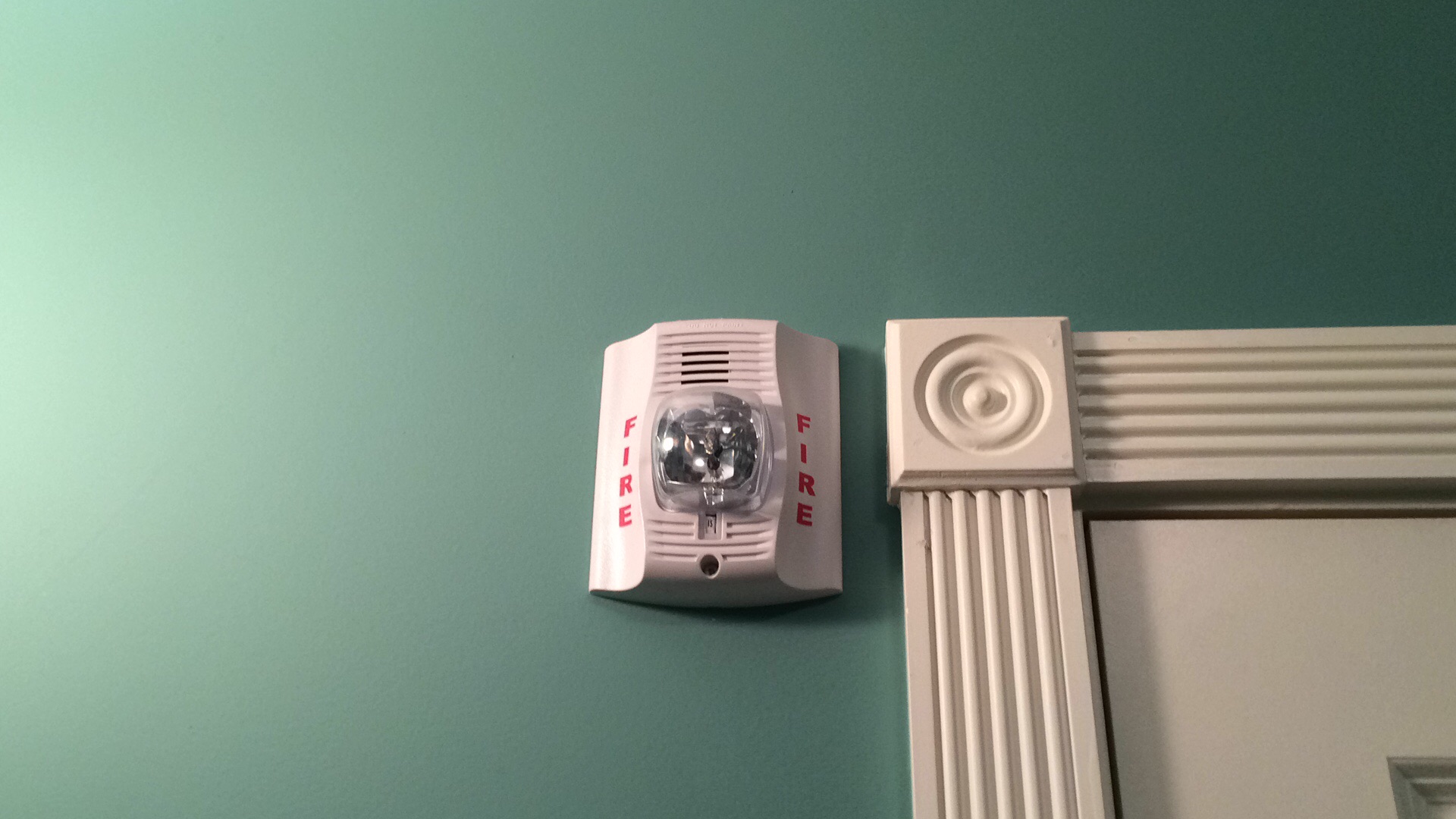

I walked in to a restroom (single person) to find this:
I know the intent is to let people know the alarm is going off, but this is overkill for a 4’x6’ area, even if it was (although, probably not) set on low volume. Is there anything against this? Would it exceed the dB limit in that small of an area? I’m usually okay with the SpectrAlert Advance, but this has crossed the line.
Any thoughts on why this was installed in an area not much bigger than a closet?
That is kind of overkill. It may also depend on who designs the building. The Walmart I worked at had ceiling-mount SpectrAlert Advances everywhere, even in smaller offices. But then again, the Walmart corporation actually designed the alarm system, and that’s what they wanted. (I do remember the horn/strobe in the break room was on low volume, but of course they’re louder in bigger, more open areas.)
Even low volume would be overkill. Just a high candela strobe would be enough.

I can think of a couple of scenarios…
1.) Prints said horn/strobe - installer thought it should be a strobe - boss told him to go by the prints
2.) Prints said strobe - installer grabbed a horn/strobe and snapped it in place by mistake (which is possible because it’s not uncommon to some people to put a horn/strobe in box that has a strobe model number because they lost the original box and were too lazy to sharpie the box with the right model)
3.) Lazy installer who just didn’t care what the prints said and just grabbed one
4.) AHJ specified a horn/strobe for some ungodly reason
5.) Someone after the fact took them down and just randomly placed them back onto the mounting plates (we one had painters take down a bunch of addressable smoke detectors to protect them but then just randomly placed them back messing up all the location descriptions)
My money is on #4!
If that were so, I’d make the final decision maker listen to an Advance going off for 3 hours! Not really, but if it were up to me, I’d require strobes, or chime strobes if an owner wants audible.

Alarms in restrooms are generally a mixed bag. Very few places that I have been had horns in the bathroom and most of the time are just strobes. I don’t even know WHY you would put a full horn in the bathroom.

It’s possible if this is a 4 wire device the horn isn’t even connected. I’ve seen this done once with a Simplex TrueAlert in a small corridor of the middle school I attended.
