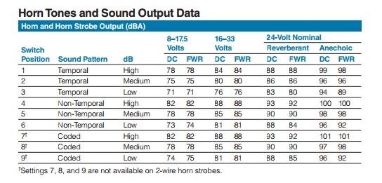

Wouldn’t it be against code of the echoing made it louder than the ~120dB maximum?
110 db and it won’t be. it’s extremely difficult to get above even 100 db.
Those horns wouldn’t be above 75dB at 10 FT.
What about the Advance?
This should answer all your questions:
Basically the other Chris is right, it would never really ever get above about 100dB.
