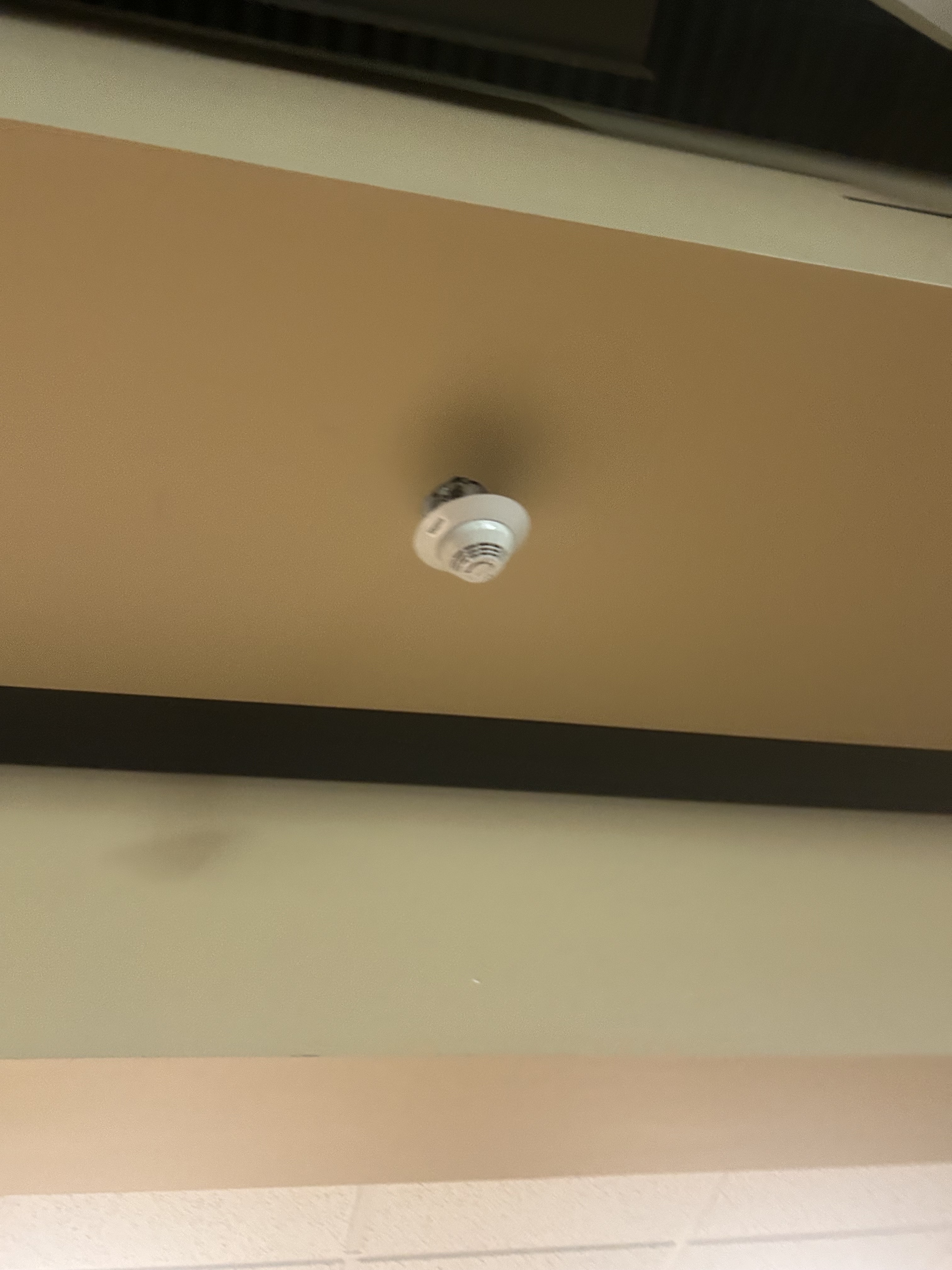

It’s not necessarily the installer’s fault. Given that there is paint on the device (another fail), it might be a result of someone who painted or modified the wall.

It was always like that when the system was installed in 2014-15 ish, it was at a home depot, so they shoudlve fixed it lol

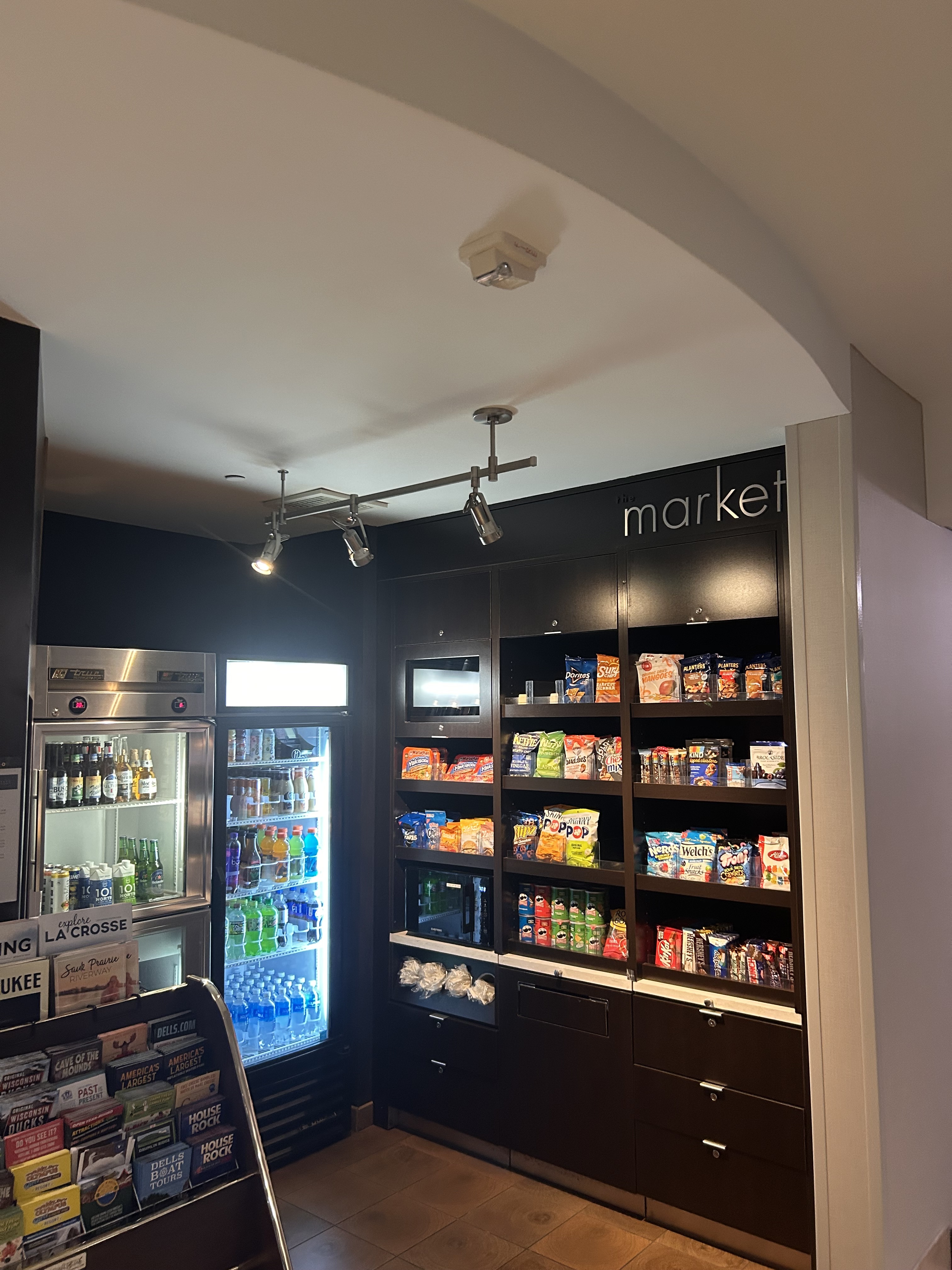

Ceiling mounted white Gentex commander 3 at a hotel I was recently at.
As I said. It’s really not a fail, unless like here, the strobe is not visible in a 360 degree direction.

It’s debatable, it’s intended for wall mounting.The strobe is probably fine, but the fire lettering is not very legible, that adds to the fail.

The strobe is not fine because it is not listed for ceiling mounting. The light distribution requirements are different for wall and ceiling devices.

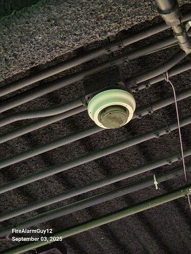

Sideways 4903 and a TrueAlarm missing the chamber cover (idk if you’d count that, but I did.
The 4903 is not a fail. These are already made by simplex. The strobe and fire lettering is clear for those.
I assumed the strobe wouldn’t be rated for mounting like that (considering there are vertical units for retrofitting situations like this).
